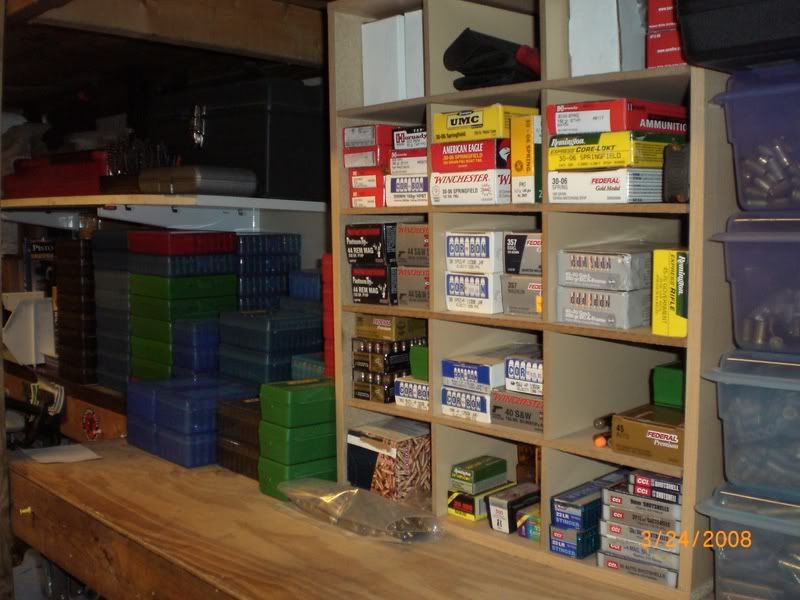

For entry level I don't think you can beat an RCBS Rock Chucker single-stage press, and they come in starter kits that include a lot of essential equipment. It is definitely more time-consuming using a single stage, but IMO it's the best way to learn, experiment and become proficient at handloading before moving to a progressive. And depending on the amount of ammo you intend to load, it may be all you really need.
I loaded all the ammo in the plastic boxes on a Rock Chucker...
